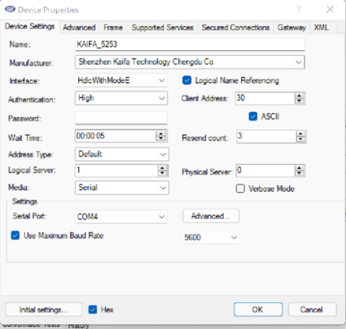

it's been a while that i get from the vendor all securities parameters in order to connect in HLS GMAC to the meter and trying to get data from the meter. but i keep struggling to establish this connection by using GXDLMS with the suitable application context that i get from the communication between the meter vendor software and the meter.
i want to understand why the connection keep faikling, and your help to set the right application context for this.

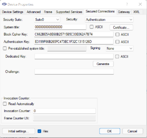

securities parameters from the vendor( kaifa)
· Upper Address ? 1
·       Lower Address ? 0
·       Serial Number ? 30105253
·       Authentication mode: HighGMAC? HLS-GMAC
·       Security: AuthenticationEncryption? Yes
·       Source Address (or Client Address) ? 0x30
·       Password ? NO password
·       System title ? 4D4D4D0000BC614E
·       Block cipher key (encryption key) ? C662BE5A8E68B25715B5C33E062A7B74
·       Authentication key ? E3199F66B265FC473EC1F32C1315126D

Hi, Vendor software is not…
Vendor software is not using GMAC or ciphered connection. It's using High authentication. Try to remove GeneralProtection, GeneralBlockTransfer, and DeltaValueEncoding from the supported services tab.

Hi, obviously i followed the…
Hi, obviously i followed the same setting as did the vendor and also i did follow your advise for GeneralProtection, GeneralBlockTransfer, and DeltaValueEncoding but the outcome still the same . the server stop replying after the AARQ.

3 years 7 months ago
In reply to Hi, obviously i followed the… by zeus8497st
Hi, You have selected…
You have selected HighGMac when another application is using High. Change HighGMac to High and try again.
