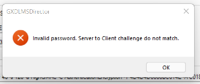

Gurux.DLMS.GXDLMSException: Invalid password. Server to Client challenge do not match.
à Gurux.DLMS.GXDLMSClient.ParseApplicationAssociationResponse(GXByteBuffer reply)
à GXDLMSDirector.GXDLMSCommunicator.InitializeConnection(Boolean force)
à GXDLMSDirector.GXDLMSDevice.InitializeConnection()
à GXDLMSDirector.MainForm.Connect(Object sender, GXAsyncWork work, Object[] parameters)

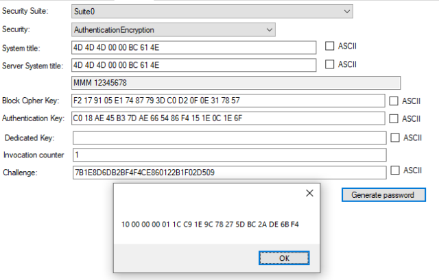

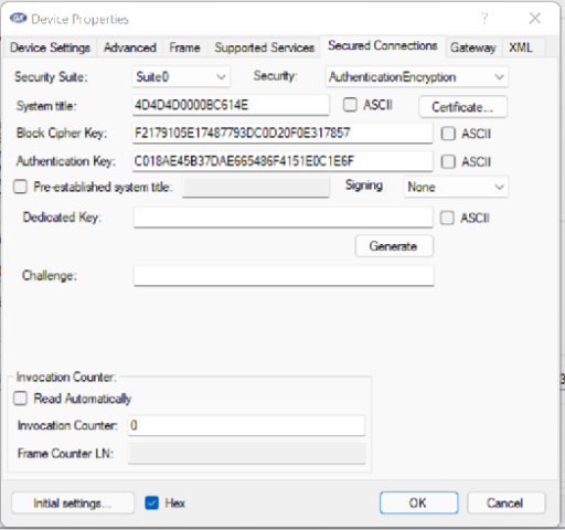

here is the setting for
here is the setting for security parameters.
3 years 11 months ago
The server challenge is invalid. You need to ask firmware update from the meter vendor where this is fixed.
Authentication key: C018AE45B37DAE665486F4151E0C1E6F
Client challenge: 3B5E683D043B68412D49675D1D756609
Invocation Counter: 2
Challenge that meter returns: 10 00 00 00 02 86 2F 07 9F 5E E0 09 9D 02 B0 95 90
Correct meter challenge: 10 00 00 00 02 06 CC 89 A0 2F 9C EE B1 06 C6 06 B8

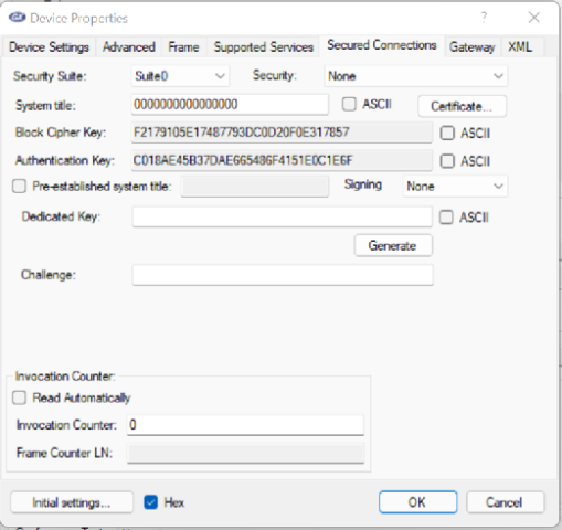

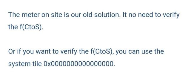

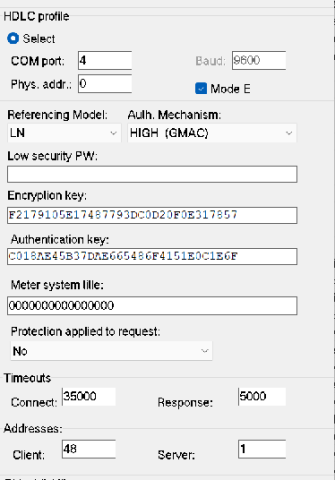

Hi thanks for your kick reply
Hi thanks for your kick reply.
Is there anyway to compel the meter to send the right value or not to simply check the f(CtoS) by changing the system title to 0x00000000 or something else ?
By the way, how do you found the correct meter challenge? Can you share with me some way compute it?
Thanks in advance.
The meter uses its system title, authentication key, invocation counter, and challenge to generate the f(StoC). There is nothing you can do about this. Ask the new firmware where this is fixed.
You can count the CtoS or StoC by selecting "Tools" and "DLMS Translator". Select Ciphering tab and set the correct values and press "Generate password". You can see the CtoS in the message box.
zeus8497st
Thanks for your feedback.
Seem like i can do much to set this.
But thank you for all your help and support.
I will try to follow your advice. If there's any issues, I will make you know, thanks.

Was thinking this and it might be that the meter expects a certain (static) client system title and uses that one, not the one that comes in the AARQ request.
Check from the meter documentation if the client system title is defined there.
Now you have used the same system title for the client that the meter uses.
zeus8497st
3 years 10 months ago
I guess but I also ask the manufacturer the right system title but he replied ( picture) that there's no need to check f (CtoS).
And seems like we can't avoid checking the f (CtoS), i use the one that they gave back me but I get the same outcome like before.
So don't know where the point is !
Or is it possible to not put any system title and using an HLS with LN context name?

And are these values:
\ICU00001
4D4D4D0000BC614E
some standard value which any meter know .
I see them often while searching.
Of course, f(CtoS) needs to check. But I checked this and if you use 0000000000000000 as a client system title it will generate the correct result. I believe that you can read the meter if you use 0000000000000000 as the client system title. The best option is update the firmware for the meter where this is fixed.
zeus8497st
HI
HI
thanks for your reply
i try to use this values of system title (0x0), but the problem remains. cause of after successfully replying the AARE, the client send back an break message to stop the connection.
don't know why but i try with several tools like Ezreader but there also i got an invalid frame length for the AARE.
i want to follow your path , although i don't get the firmware update from the vendor.

error from ezreader
error from ezreader
Please, don't add multiple questions for the same topic. I don't know what the problem is at the moment.
You have sent the AARQ and get the AARE from the meter, but you didn't add the next messages.
zeus8497st
HI,
HI,
thanks for your feedback
for the 0x000.....
in both case the software use sends a disconnect request after receiving the AARE
GXDLMS: send a break message " 01 42 30 03 0D 0A" == SOH.B.0.ETX.CR.LF
Ezrezader: send a disconnect request "7EA0080201615354527E" with an error " the system title receive doesn't match the declared value"
i start figure out the issue for me it's the security level which doesn't match with the application context, i' m trying to use lower security level (without syst_title) with the the application context "LN"
thanks for your help.
