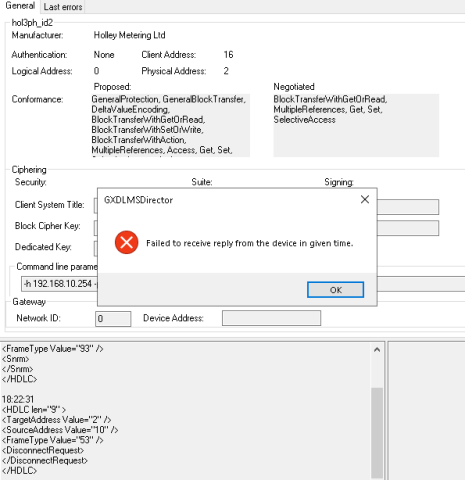

Further information:
The attached picture showed the error received in Scenario 3:
4 years 1 month ago
There are some differences in how multidrop is implemented for different meters. You need to change the server address. Don't change anything else.
In first you can try to connect using the serial number. Change meter address type from Default to SerialNumber. Then set serial number of the meter 2. Try to connect.
If it fails, some meters expect that you will add meter 2 to the SAP Assignment table of meter 1. This is more complicated, so start with the serial number.
