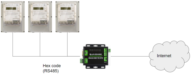

I'm trying to connect multiple meter by RS485 and read data but don't know how to read them one by one
I think I need to identify by Device ID
But don't know how to do?
4 years 4 months ago
Read Device Address from the IEC HDLC setup and use it as the physical server address.
