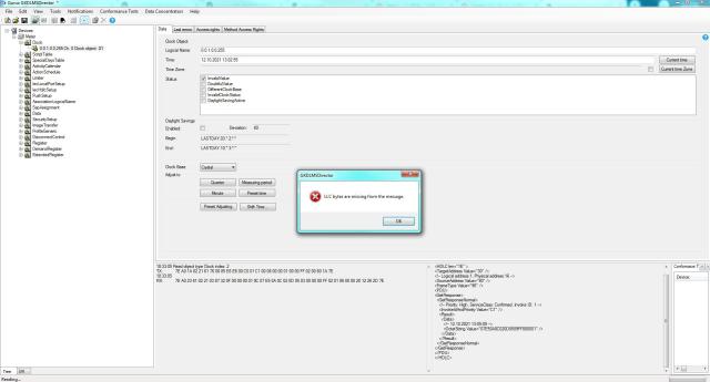

Hi!
After update to GXDLMSDirector 8.2.2112.2101.
When I try read from meter any data (for example object Clock with obis-code 0.0.1.0.0.255) I get PUSH-message from meter. But this message put into "Trace TextBox" and application get me Error Message "LLC bytes are missing from the message" and data not receving.
Before update i don't have any problem with DataNotification.
Please check this problem. Thx for help

I get in trace only this
13:46:50 Read object type Clock index: 2
TX: 7E A0 1A 02 21 61 54 18 87 E6 E6 00 C0 01 C1 00 08 00 00 01 00 00 FF 02 00 60 1A 7E
13:46:50
RX: 7E A0 23 61 02 21 03 87 32 0F 00 00 00 01 0C 07 E5 0A 0D 03 08 12 29 00 80 00 FF 02 01 06 00 00 20 12 3B 07 7E

Your date notification Frame type is 0x3 and it should be 0x13 because it's the last HDLC frame.
7E A0 23 61 02 21
03 //This should be 0x13
87 32 0F 00 00 00 01 0C 07 E5 0A 0D 03 08 21 05 00 80 00 FF 02 01 06 00 00 20 12 96 C2 7E
This frame type check is improved because there are meters that are using HDLC Window size other than one.

I believe that I have a design that can handle this when HDLC windows size is bigger than 1 and in your case. This will be included for next week release.
4 years 5 months ago
This is improved and the new version from GXDLMSDirector is released on Monday.
You can try this if you update Gurux.DLMS.Net component to Version 9.0.2201.2801.
LLC bytes are missing from your push message and it will cause that parsing will fail. You need to fix that.
7E A0 23 61 02 21 03 87 32 //LLC bytes are missing.
