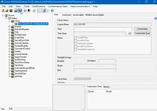

By kytsai41 , 17 January, 2022
When the access right of object is AuthenticatedRead or AuthenticatedReadWrite, press "Read" button can not read anything.
4 years 8 months ago
You have connected without authentication (Public client). You can only read values, not change them. You need the authentication level password and then change the authentication level and client address to the correct ones.
