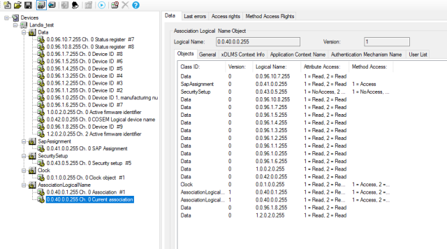

i can connect to the E450 Prime meter (L&Gyr) and even read it but where does it show the actual meter readings? I did not put any password anywhere. Do i need some password? This meter is in Spain. See screenshot attached

This is the data that you can see without a password. If you can get the password try to change the authentication level to Low and set a correct password. Then select "Refresh" from the "File" menu. It will read the object tree and you can see more objects on the left side.
