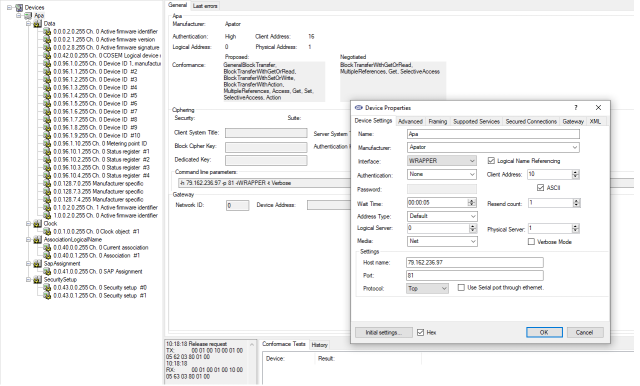

I'm trying to read Polish Apator meter via Gurux Director with no success. The meter is available via public ip address. Maybe anyone connecting via Gurux to this meter? Data to connect which provider send to me are:
Manufacturer identifier : APAESX30
Authentication: High
Password: 01234567
Serial number and address ip with port.

I get this data from
I got this data from manufacturer:
IP WRAPPER, association public:
000100100001001f601da109060760857405080101be10040e01000000065f1f040000fc1fffff
4 years 10 months ago
Change interface from HDLC to WRAPPER. Then set the IP address and port and establish the connection.
Let me know if you succeeded to connect and default settings are added for the manufacturer so it's easier to connect in the future.

Yes now working with this
Yes now working with this setting. But I cannot sea Load profiles on list. but there is a partial success.

I used authentication in High level with password from manufacturer. And I'm trying to connect using client address 10 and I get an error: connection is permanently rejected. Authentication error.
I ask manufacturer for proper client address but they said that communication should look like:
We are connecting with meter using public connection without password, after connection program should send password and authentication method and after that secured connection is set between program and meter.

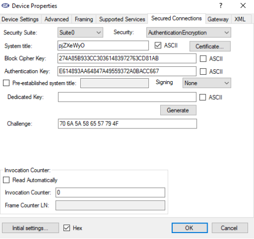

Select "Secured connections" tab from meter settings and
Set authentication key to "Authentication key" and Unicast to "Block cipher key".
Then change Security from None to "AuthenticationAncryption".
Change Authentication from None to HighGMAC.
GMAC doesn't use passwords, so forget password hexvalue and try to connect.
If it fails, try to set 706A5A586557794F to "Secured connections" Challenge field.
I hope that you can connect.

I have one more question:
I have one more question: what set into a filed: system title?
The client system title can usually be any 8 bytes long value. I notest that in your settings password
length is 8. To this:
pjZXeWyO
It's 706A5A586557794F in ASCII format.

I set all the paremeters that
I set all the paremeters that you suggested but I still cannot connect with the meter. When I try to connect with GMAC and client adress 10 I get error: Connection is permanently rejected The application context name is not supported. Meter Expects Logical Name Referencing.
I have set option for logical name referencing.
There is a response for client address 10 and authentication GMAC:
10:35:26 Send AARQ request.
00 01 00 10 00 01 00 57 60 55 A1 09 06 07 60 85 74 05 08 01 03 A6 0A 04 08 70 6A 5A 58 65 57 79 4F 8A 02 07 80 8B 07 60 85 74 05 08 02 05 AC 0A 80 08 70 6A 5A 58 65 57 79 4F BE 23 04 21 21 1F 30 00 00 00 00 26 74 8B 20 D2 6F D5 EE AE 99 73 D8 C1 B1 FB 29 1E 44 ED 7F 47 B0 C0 E1 A3 AF
10:35:26
00 01 00 01 00 10 00 2B 61 29 A1 09 06 07 60 85 74 05 08 01 01 A2 03 02 01 01 A3 05 A1 03 02 01 02 BE 10 04 0E 08 00 06 5F 1F 04 00 00 12 14 01 80 00 07
When I change client address for 14 the meter doesn't response. I attached the setting for secured connection.

Finally I connected with this
Finally I connected with this meter. I was changing client address as you mentioned and I finally hit it in address 0x02. Now I have got full access to the meter and can read Load profiles. Thank you for your help.
