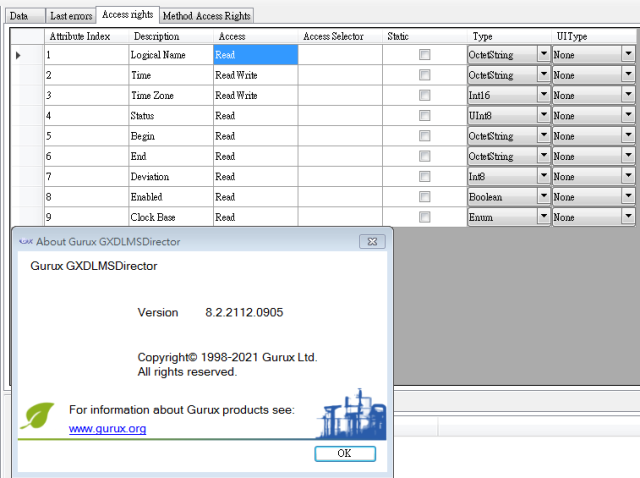

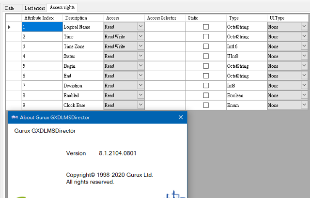

The older version can change the access right of object before.
After upgrading to the new version, the access right can not modify.

You can't change the access rights. The meter gives access-right levels when the association view is read. It was possible to change the access-right level in the old version, but that was removed because it was causing so many misunderstandings.
Select "File" and "Refresh" to update access rights for your current association.
