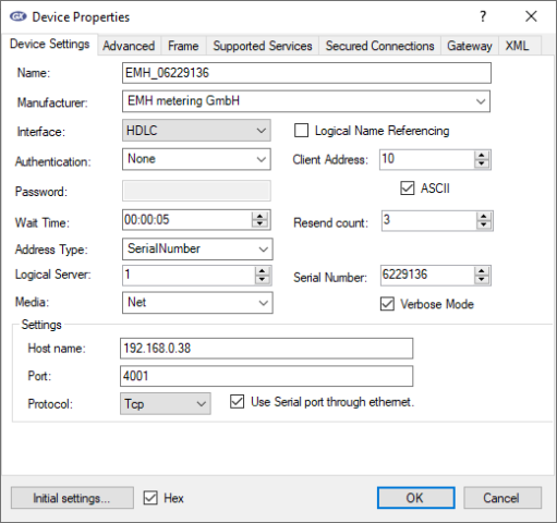

My EMH LZQJ-CX is connected via a serial port server (Moxa). The serial port server operating mode is TCP Server. GXDLMDirector connects to that meter without a problem. I copied command line parameters from GXDLMDirector and tried to use them as parameters for Gurux.DLMS.Client.Example.Net. Unfortunately, this time the meter did not respond to the SNRM request. I have compared SNRM frames sent by GXDLMDirector and Gurux.DLMS.Client.Example.Net, and they are different. I wonder why.

Command line parameters: -h 192.168.0.38 -p 4001 -r sn -n 6229136 -t Verbose
