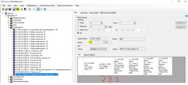

I have become a real fan of your software, unfortunately I keep running into problems, so here's a question again:
When trying to read a profile no data appears. There are 10 entries, which I can read out without problems using .MAP110 (software from Landis+Gyr). In the Director this usually does not work. Sometimes data appears but most of the time it does not. Do you have any idea what the problem is?

This looks strange. Can you read the data and add a log here so I can check the bytes?

Strangely, I can no longer reproduce the error. Possibly it was at the meter.
I will get back to you if it occurs again.
