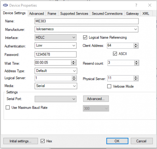

I´m trying to read meter ME383 with Iskraemeco default configuration through serial port but I´m getting "Failed to receive reply from the device in given time." message from GuruxDirector.(9600 8N1).

If you are reading your meter with an optical probe the Interface must change from HDLC to HdlcWithModeE. I don't know if you have done it, but in the picture it's HDLC.
Try to establish the connection using an optical probe first. The baud rate can be anything and if it's wrong the meter doesn't reply.
You should receive a reply if you are using an optical probe. Connection is started with IEC 62056-21 mode E and the meter should reply if the baud rate is correct.

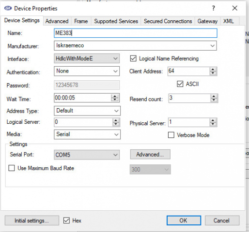

Try to change authentication to None and Logical Meter address to zero and Physical Address to One.

I tried new configuration with no success. This is the log:

Try to change the client address from 0x64 to 0x10. If it still fails change the logical address to 1 and the physical address to 0x21.
Is this your own meter or is it an electricity company meter? If it's electricity company meter, it might be that the server address is changed or the DLMS part is disabled for the optical probe.
