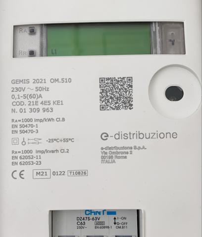

I am attaching a picture of the meter.

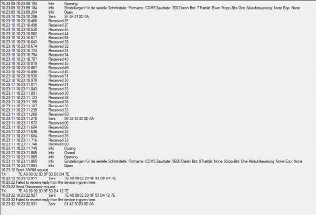

Here is what we get (see attached image).
If we could get an error number or at least some error, will be a good start.
What else we could check? The optical probe is working well on other meters, but maybe the configuration is wrong for this meter....

So what we have with GXDLMSDirector instead is the ID of the meter: //EDi521........
Received 2f
Received 2f
and so on in HEX.

It might be that the optical probe supports only IEC 62056-21.
You can try to connect with the terminal to the meter and send "/?!\r\n" and nothing more.
Serial port settings are 300 7Even1.
Let's see if the meter returns readout.
