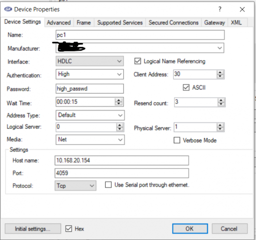

Hi!
Is it possible on server side?
I want connect to server with low auth and high auth from DLMSDirector. But OBIS 0.0.40.0.0.255 (CGXDLMSAssociationLogicalName) support only single secret.
I added CGXDLMSAssociationLogicalName with name 1.1.40.1.3.255 with secret "high_passwd"

In method void DLMS_Server::create_passwords() i create two instances for low and high passwords.
In ValidateAuthentication() method i check password from 0.0.40.0.2.255 when DLMS_AUTHENTICATION_LOW and it works OK.
But when i connect DLMSDirector with high password - fail. Wrong password.
If i in DLMSDirector password for high authentification set "Gurux" - OK.
What i'm doing wrong?
Thanks!
