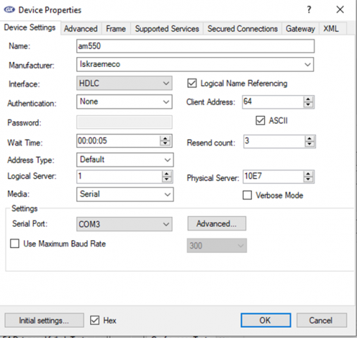

I have Iskra AM550-T (serial: 83 694 327) connected via serial port. I try to connect several times with different parameters but all time get errors like this

I think that something wrong with addresses.
One of setting see in attachment.
In one manual (for MT880) I found information " MT880 meters support single byte HDLC addressing. Default HDLC address set in the meter is calculated as follows: HDLC address = Last two digits from meter serial number + 10H " , but this don't work also.
Can anybody say right setting to connect to this device ?

MT880 settings might be different than AM550.
Try to change client address to from 64 to 1 and logical server to 0 and physical server address to 2B (Last two fight 27 + 16 = 27 = 0x2B).
