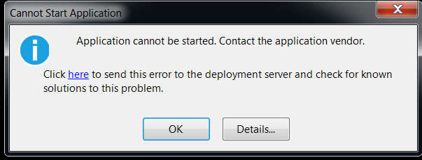

I wanted to install GuruxDLMSDirector on my Laptop. I have already installed .NET 6.1, still while installing Gurux I am getting the error
"Application can not be started. Contact the application vendor"
I am attaching an error screenshot for your reference.

at System.Deployment.Application.ApplicationActivator.PerformDeploymentActivation(Uri activationUri, Boolean isShortcut, String textualSubId, String deploymentProviderUrlFromExtension, BrowserSettings browserSettings, String& errorPageUrl, Uri& deploymentUri)
at System.Deployment.Application.ApplicationActivator.PerformDeploymentActivationWithRetry(Uri activationUri, Boolean isShortcut, String textualSubId, String deploymentProviderUrlFromExtension, BrowserSettings browserSettings, String& errorPageUrl)
--- End of stack trace from previous location where exception was thrown ---
at System.Runtime.ExceptionServices.ExceptionDispatchInfo.Throw()
at System.Deployment.Application.ApplicationActivator.ActivateDeploymentWorker(Object state)
COMPONENT STORE TRANSACTION DETAILS
No transaction information is available.
5 years 3 months ago
This is a different error. Your Windows doesn't support Yiddish and that is causing the problem.
Windows 7 support has ended so I believe that the easiest way is if this is removed from the next version of GXDLMSDirector.
pandere.nisha1…
Okay, Then should I upgrade my windows version?
Or else will have an option of GuruxDLMS to support this version of windows.
The fastest way is if you download the GXDLMSDirector and build it with Visual Studio. The next version is released next week.
