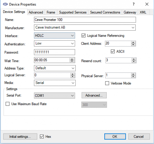

HI,
I am trying to use Gurux Director to download a DLMS meter via an optical probe connected to the serial port. In the past there used to be an option to specify the start protocol as IEC, however that seems to be removed?
Attached is the screen I'm seeing when trying to add a new device.
Am I missing something?
5 years ago
Change interface from DLMS to HdlCWithModeE. HdlCWithModeE is the same as IEC start protocol.

That solved it. I knew I had
That solved it. I knew I had overlooked something.
