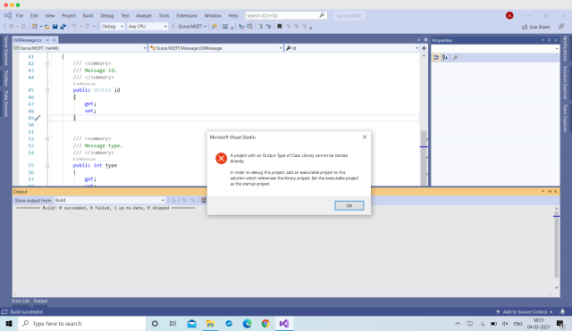

Dear Sir
Dear Sir
I build the code but it is giving the error message as per attached screen shot, where i am missing. please help
5 years 8 months ago
Hi Manish,
Hi Manish,
This is not an exe that you try to run. Try to run bridge and broker to get started.
