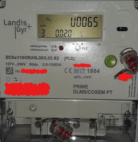

Ladies and gentlemen may i
Ladies and gentlemen may i present to you... my cute landis! :)
5 years 8 months ago
Looks good. If you have the optical cable you "should" be able to read the meter.
There are country differences in the metrics, so I can't say for 100% sure.

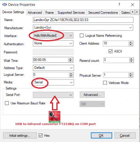

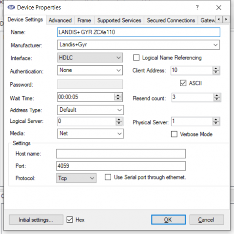

Any tips to fill the form
Any tips to fill the form correctly to connect with GXDLMSDirector?
If you select Landis+Gyr as the manufacturer you should be able to connect right away.
Change Interface from HDLC to HdlcWithModeE if you are using an optical probe.

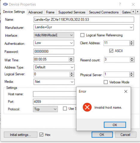

Name: Landis+Gyr ZCXe110CRU0L3D2.03.S3
Manufacturer: Landis+Gyr
Interface: HdlcWithModeE
Authentication: Low
Password: 00000000
Tab Frame-> Server Address size -> 4
Hostname?? what hostname? localhost? why do i need a hostname?
You try to connect using TCP/IP connection. If you want to read using a serial port, change Media to Serial.

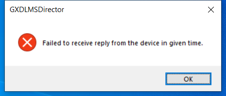

after few attempts...
after few attempts with:
Authentication: Low
Password: 00000000
change Media to Serial -> choose correct COM port
5 years 6 months ago
If you are using the optical port you need to use HdlcWithModeE and if you are using direct serial port your interface type is HDLC.
L+G meter what we have, are using 1 byte addressing. Why you have changed Server Address size to four?
pbtek
Thu, 11/26/2020 - 09:39#15
#1. This is now updated. You can "Server Address size" to 4 in Frame tab.
i am using an optical port. did lots and lots of attempts... no luck. i am not able to connect.
Can you give more details from the optical probe?
Are you receiving any reply from the meter?

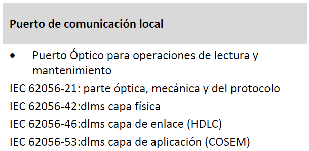

Some detais...
Some detais...
Can you share the link to where you have bought this or do you have a link to the probe?
