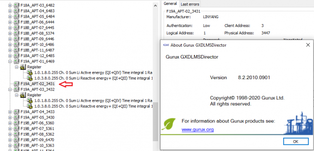

I created a device list (.gxc extension) containing about 170 devices, each device has two object/attributes (1.8.0, 3.8.0).
All devices and objects/attributes are loaded successfully except for only one random device, the device is shown in device list but without any objects. Every time I reload the file I have different device with the same problem.

This is tested with several PC's and it's opened as expected. What is your .Net Framework version? You can see it if you select "Library Versions..." from the "Help" menu.

I have same problem with two
I have same problem with two PCs, just tested right now and I have same problem with the same file I sent to you.
PC-1:
.NET Framework 3.5 SP 1 3.5.30729.4926
.NET Framework 4.0 4.8.03752
PC-2:
.NET Framework 4.0 4.8.04084
5 years 10 months ago
Thank you for this info. This is now solved and the reason is found. Uncheck "Groups" from the "View" menu. A new version is released next week where this is fixed.
