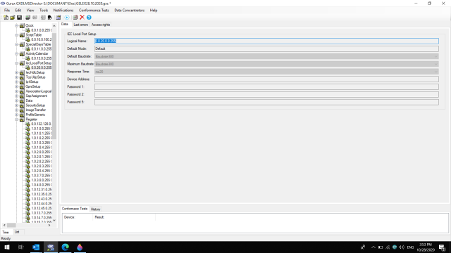

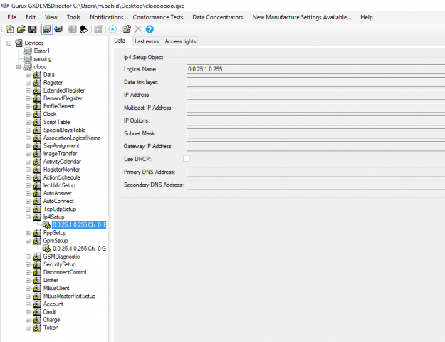

why I can't read and modify the objects , like this one below (IP setup) :
5 years 11 months ago
Meter doesn't allow that. Check your authentication level. You can see access right by selecting Access Right tab.

Please let me know that i can write the address for logical and physical because i would like to connect more than 3 energy power meter type DLMS ( Iam sing Gurux Director ... and the i can use Local port set up..0.0.20.0.0.255 ??? thats OK ?? )
Thank you very much

Hi BuiLy,
Hi BuiLy,
Please, create a new topic if you have a new question. Physical addresses are listed in the SAP table.
