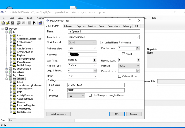

Hi sir,
We are able to collect all the profile from meter but when we read the billing profile data it shows the exception. below is the hex log of the meter.
[Trace removed]

Please, don't post updates. I'll answer when I have time.
Meter sends invalid data. There are 151 columns and rows 13. Meter returns the amount of the rows (151) using one byte and it's wrong. Ask the meter manufacturer to fix it.
