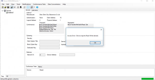

Hi Mikko ,
when i want to read the objects of CLOU CL710522 , i get this error message :
6 years ago
It might be that the association view is not implemented for your meter.
Select "Add Object" from "Edit" menu and add Clock object. Set Logical name to 0.0.1.0.0.255 and apply changes. Make a new connection to the meter and try to read the clock.
If you can read the clock object you need to add all objects by manually. You can get the list from the meter vendor.
