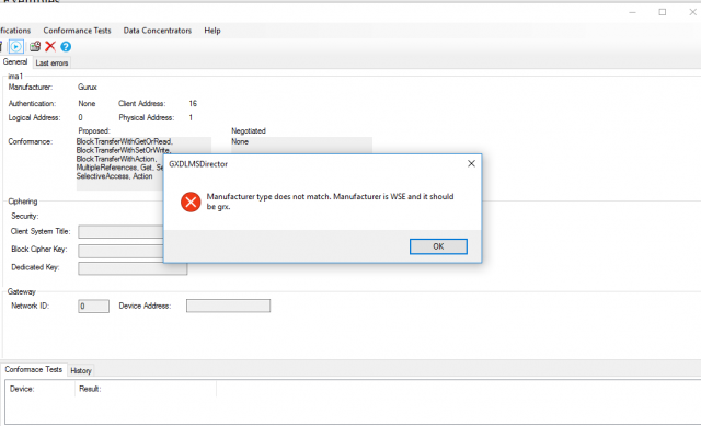

Hi ,
Hi ,
It give me this error message with IEC and after changing baud-rate
6 years ago

Hi Mikko ,
Hi Mikko ,
Settings for WASION still not exist .
5 years 12 months ago
You can see the manufacturer with an old name: Changsha Weisheng Electronics Ltd.
We'll update name to new one: Wasion Group Co.Ltd.
You can communicate with the old name at the moment.
mohamadop
Not working ,
Not working ,
It gives me the error message "failed to receive reply from the device in given time " with the devices properties bellow :
Change start protocol from IEC to DLMS. I don't know the baud rate, so you must try different compinations.
