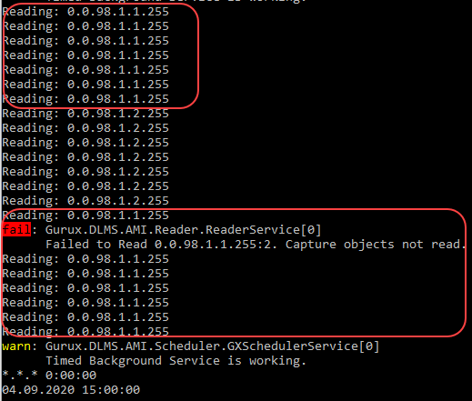

I try to read 0.1.99.98.4.255 and an error occurred:
fail: Gurux.DLMS.AMI.Reader.ReaderService[0]
Failed to Read 0.1.99.98.4.255:2. Capture objects not read.

I downloaded the latest version of AMI. In the director, I added a device, then added it as a template in AMI. Read object 0.0.98.1.1.255, then another object, then 0.0.98.1.1.255 again. An error has occurred.
The first time the object is read, the second time - an error. This happens with all profile generic objects.
