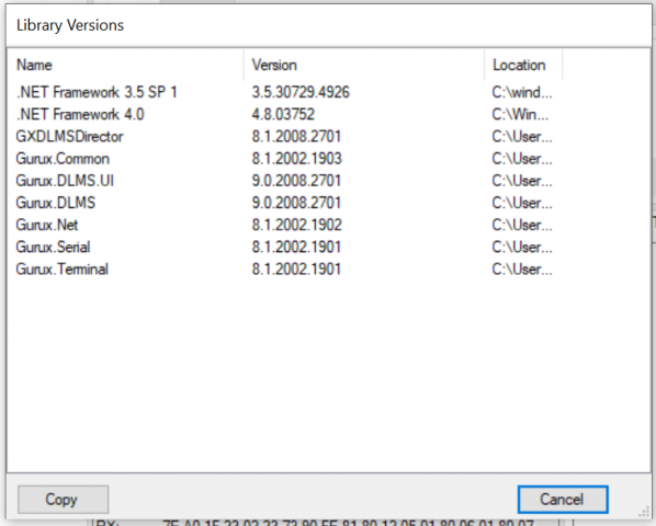

  3. Association With HighGMAC Is Not Connecting With Version of Gurux Director 8.2.2008.2701
Association with HighGMAC is not connecting with version of Gurux director 8.2.2008.2701
By RiteshNaik , 1 September, 2020
With latest version of Gurux director 8.2.2008.2701; Association with HighGMAC is not connecting for HDLC over local port it gives exception "service not allowed", with older version it is working fine.
With Regards,
Ritesh NAIK

5 years 10 months ago
I know the reason. We changed the Invocation Counter to increasing for one of our clients. That is causing problems with your meter. I talked with our client and we'll revert this back. New version is released today.
A new version is available. Try with that and let me know if you have any problems.
RiteshNaik
Thanks a lot, It is communicating with new updates with version 8.2.2007.0602.
