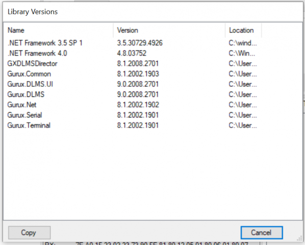

HLS is not working with the latest version of Gurux director 8.2.2008.2701.
With the same project file, we can connect with an older version 8.1.2006.2302.
We are facing this issue with HDLC over a serial port.
Kindly let me know if you need more information.

HI,
HI,
With latest version of Gurux director 8.2.2008.2701; Association with HighGMAC is not connecting for HDLC over local port, with older version it is working fine.
HDLC Logs:
15:35:48 Send SNRM request.
TX: 7E A0 08 02 23 23 93 0D 57 7E
15:35:48
RX: 7E A0 1F 23 02 23 73 90 FE 81 80 12 05 01 80 06 01 80 07 04 00 00 00 01 08 04 00 00 00 01 53 3B 7E
