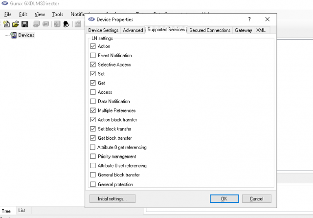

5 years 11 months ago
Below is the list of selected services.
