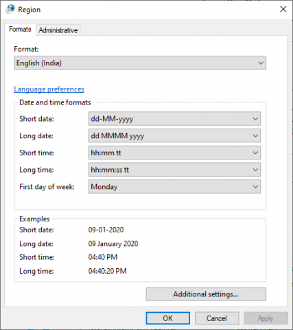

What is your Windows date-time format?
https://www.windowscentral.com/how-change-date-and-time-formats-windows…
What is your GXDLMSDirector version?
Select "About" from "Help" menu.
Thanks, Mikko for your quick
Thanks, Mikko for your quick reply.
My system date format is "dd-MM-yyyy" and GXDLMSDirector version is 8.2.1912.0501
What is your Region and format?
