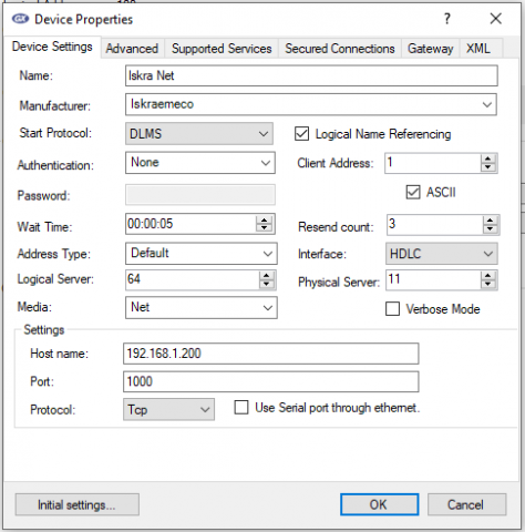

i'm tryng to read one Iskra MT831 with ethernet connection but I receive a message "failed to receive a reply from the device in given time".
I have used the settings suggested in "See default initial settings" without success.
Normally when i read the counter with another program ( lpreport from one Italian company ) I should insert also the serial number of the counter in order to get one answer but in GXDLMSDirector i can't find the right place were to insert this parameter.
I'm looking forward to receive any possible solution...
Thanks a lot!!
Kind regards
Emanuele Giasi
6 years 6 months ago

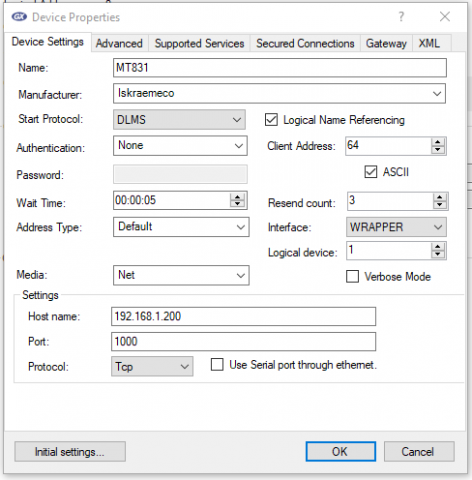

attached you may find the screenshot of the settings
I also tried Client Address to 100 and logical Address to 1 and a lot of other combination with no success
Thanks a lot for hour help
Regards
EG

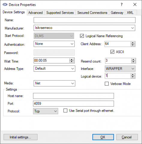

Hi Emanuele,
Hi Emanuele,
If you are using TCP/IP connection try to change the interface from HDLC to WRAPPER.
Then also change the Logical Device to 1.
Make sure that client address is 64.

thanks for you answer, attach you may find the configuration I used and the logs that I get.
I always receive the error "failed to receive a reply from the device in given time".
I don't know what it can be, maybe the counter is not answering because he doesn't get the serial number in the initial request.
What do you think I can do?
Thanks a lot and regards
