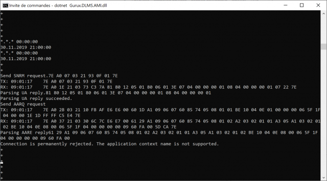

Thanks for the great piece of software. I'm trying to get Gurux.DLMS.AMI up and running to read a Landis+Gyr ZMD410 through one of their CU-XE111 IP modems.
Works fine when using GXDLMSDirector, I can read the meter and all its registers.
But then importing the .gxc file as a template and adding in the device in AMI, the console always returns "Connection is permanently rejected. The application context name is not supported."
Initially thought it could be because of Logical Name Referencing, but toggling the switch in the device properties did not help. Do you have any clue as to what could be happening?
Thanks a bunch!
Ian
6 years 11 months ago
Please, don't post images. Send text from the console. It's easirt to check what is wrong.
Your meter is using short name and Gurux.DLMS.AMI seems to use logical name referencing.
We'll checks this and let you know tomorrow.
