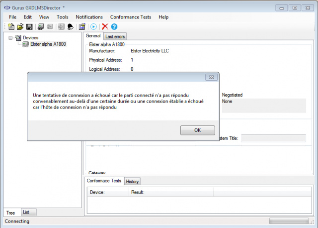

when i try to connect to my
when i try to connect to my meter i have always this message
7 years 10 months ago
I'm sure that this error is not coming from GXDLMSDirecor. :-)
I believe that the problem is that your TCP/IP or serial port connection is not working.
