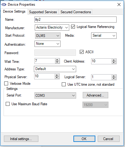

I try to get data from Actaris Electricity Meter, but it can't be continous.
After I got a success reply, then it always reply with unknown error.
I connected the meter using serial port.
The log result:
4:58:55 PM Initializing serial connection.
4:58:55 PM Send SNRM request.
7E A0 08 02 21 21 93 05 D1 7E
4:58:55 PM Received data
7E A0 08 21 02 21 73 CA 70 7E
4:58:55 PM Parsing UA reply.<CR><LF>
4:58:55 PM Parsing UA reply succeeded.
4:58:55 PM
7E A0 2C 02 21 21 10 17 2A E6 E6 00 60 1D A1 09 06 07 60 85 74 05 08 01 01 BE 10 04 0E 01 00 00 00 06 5F 1F 04 00 40 1E 1C FF FF 3B 7F 7E
7E A0 0D 21 02 21 97 B4 F7 10 00 01 6B 5B 7E
Gurux.DLMS.GXDLMSException: Unknown Error.
at GXDLMSDirector.MainForm.Connect(Control sender, Object[] parameters)
Do you know what is the problem?
Thanks in advanced.

Try to change Physical Server address to default one: 11.

still unknown error
Hi, Mikko
Thanks for your reply.
I have try this combination:
Client address: 11
Physical address: 11
Logical address: 1
Client address: 10
Physical address: 1
Logical address: 0
Client address: 10
Logical address: 1
Still didn't work.
Do you have any solution?
Thanks in advanced.

If you are using default settings you should be able to connect right away.
What model you are using?
ACE6000 or SL7000?

Well, after I check it again, I think it's a little different with Actaris.
May be it's not an Actaris meter.
I try to send the hex PDU like Director log using Hyperterminal and got some reply from meter.
But, Gurux translator can't translate it.
Is it because Gurux can't translate the longer byte?

I believe that this is not translator issue. Can you send trace to me by email so I can check it.

We made one change for the parser. Try it again.
You data is ciphered (secured) and that was causing one issue.
Now it works with your data.
