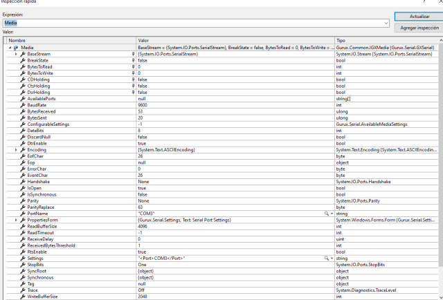

I uploaded a picture of the variable 'Media'

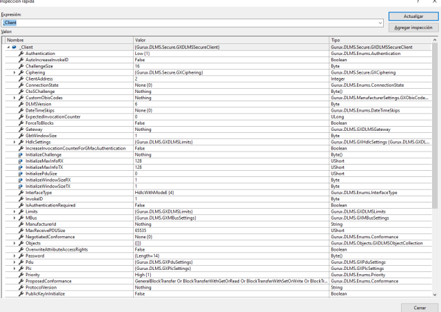

This is 'Client'
This is 'Client'

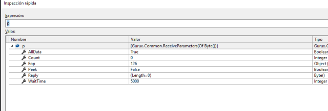

This is 'p'
This is 'p'

Your meter doesn't reply. I believe that one of your settings is different from what the meter expects. Try to read your meter with GXDLMSDirector first. It will help you to find the correct settings.
Check also your serial port settings.

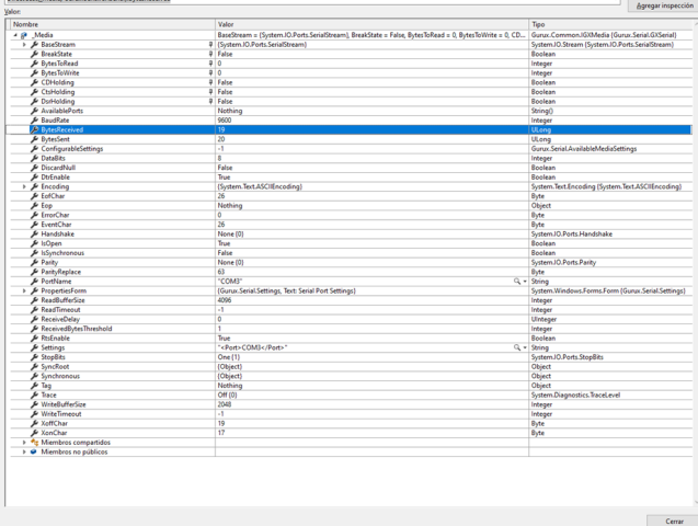

It actually reply. I check
It actually reply. I check the sniffer comunication and it does responde to the "/?!" firm.
Where is breaking is after InitializeOpticalHead(). When the program goes into SNRMRequest()
then to ReadDataBlock(data, reply) then finally to ReadDLMSPacket(data, reply)
3 years 10 months ago
The End of Packet char is 0x7E and you try to communicate with IEC 62056-21. You need to change the Eop to (byte) 0x0A. 0x7E is not sent and the received data is never handled.

When you communicate using IEC 62056-21 eop is 0xA. You need to set EOP to 0x7E when you start to communicate with DLMS.
You can check how to do this from the client example.
