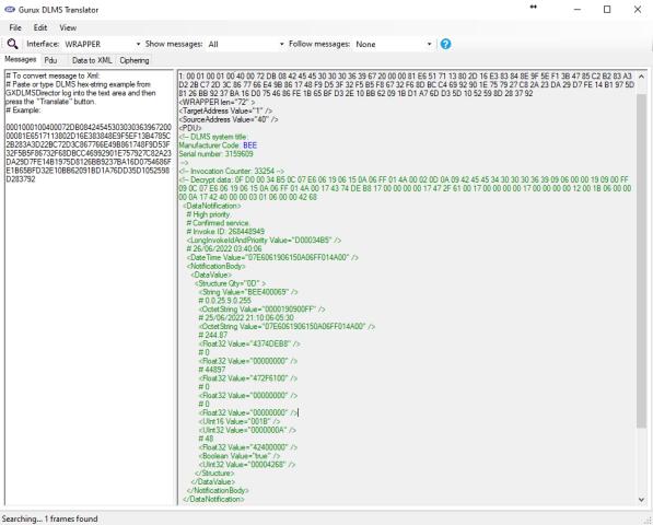

But I have also tried to use DLMSTranslater tool from DLMSDirector. The screenshot is attached.
Here is the XML output from the translator:

As you can see, the two outputs have the same decrypted data, which is great, but the XML comment result is different:
- Device ID is decoded correctly using DLMSTranslator GUI Tool, but Python API returns the empty string instead. But we can see that the decrypted data contains the correct serial meter ID in ASCII HEX: [SNIP] 42 45 45 34 30 30 30 36 39 [SNIP], or it is BEE400069, which is correct (you can see in the Decrypt data section of the XML).
- Clock register is decoded in the DLMS Translator but not in Python output.
Why there are these discrepancies between the two outputs? Am I missing some settings for Python interface or there is an issue with the Python library?
