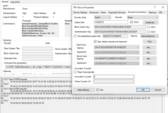

Dear Sir,
After long time trying to communicate with meter in suite1 using digital signing but it seems that
event if "Sign initiate request and response" option in security connection tab, Digital signature is not applied to the xDLMS APDU i.e user information in the AARQ by Gurux Director.
Can please help to provide info to apply digital signature to xDLMS APDU in AARQ APDU.

Dear Sir,
Dear Sir,
Can please help to provide one release with application of sign initiate request response in AARQ and AARE?
it will be very helpful for me.

we are experiencing similar issue , i.e. Our meter is expecting Digital signature in AARQ when configured for Security policy Digital_Signed_Request and Digital_Signed_Response .
Is there any recent update on supporting this feature in Gurux DLMS director ?
