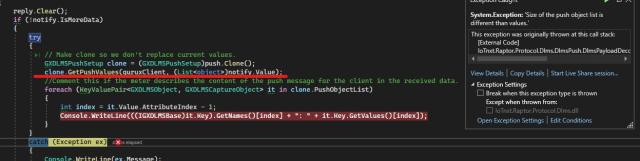

Within the if where it is defined "if(!notify.IsMoreData)" on the following line:
clone.GetPushValues(guruxClient, (List<object>)notify.Value);
The application throws an exception here stating that the "Size of the push object list is different than values."

I included a picture of the error along with the line it occurs on.

I believe that I was searching the issue from the wrong place.
You have described that there is one clock object and that is not true and this is causing the issue.
push.PushObjectList.Add(new KeyValuePair<GXDLMSObject, GXDLMSCaptureObject>(new GXDLMSClock(), new GXDLMSCaptureObject(2, 0)));
Meter sends a push message where are three objects and none of them is the date and time of the clock object. Received data is here:
<Structure Qty="02" >
<OctetString Value="3132333435363738" />
<Structure Qty="03" >
<OctetString Value="0100010800FF" />
<UInt32 Value="00000000" />
<Int8 Value="00" />
<Enum Value="1E" />
</Structure>
</Structure>
</Structure>
Read push object list from the push setup object. Then add the same objects t to the push object list in your code.

Charl Ehlers
4 years 7 months ago
Thanks for the guidance. The issue I had has been resolved
