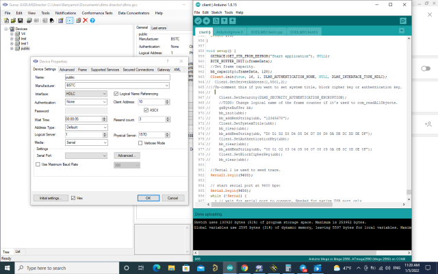

I connected the device with the gxdlms director, but does it answer this with Ardino client?
37:Data send failed. Try to resend. 1:Received bytes:
74:Data send failed. Try to resend. 2:Received bytes:
111:Data send failed. Try to resend. 3:Received bytes:
148:com_initializeConnection failed 252:Start reading:Received bytes:
4 years 10 months ago
You need to change the server address for Client.Init. Now it's One and it's different than in GXDLMSDirector.
You can count it like this:
Client.GetServerAddress(1, 0x157D, 0);
benyamin.chesh…
im change client address to
im change client address to 0x157d
And this is the answer I got؟
benyamin.chesh…

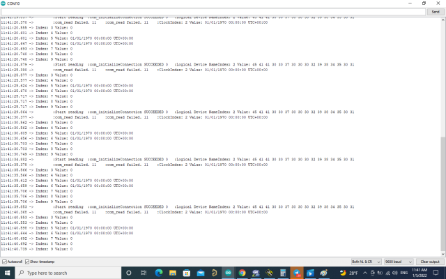

But the information I get is
But the information I get is not true
12:03:46.405 -> 0 :Start reading :com_initializeConnection SUCCEEDED 0 :Logical Device NameIndex: 2 Value: 45 41 41 30 30 37 30 30 30 32 39 38 34 35 30 31
12:03:51.052 -> :com_read failed. 11 :com_read failed. 11 :ClockIndex: 2 Value: 01/01/1970 00:00:00 UTC+00:00
12:03:51.239 -> Index: 3 Value: 0
12:03:51.239 -> Index: 4 Value: 0
12:03:51.239 -> Index: 5 Value: 01/01/1970 00:00:00 UTC+00:00
12:03:51.330 -> Index: 6 Value: 01/01/1970 00:00:00 UTC+00:00
12:03:51.376 -> Index: 7 Value: 0
12:03:51.376 -> Index: 8 Value: 0
12:03:51.376 -> Index: 9 Value: 0
