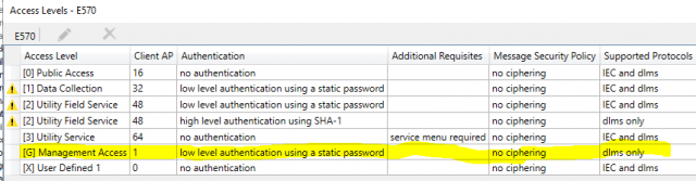

I can read via Map101 with [G] Management Access. It says it is "low level authentication with password".
Do you think I should change something else on the gurux side? (I have the correct password)
I cannot connect with GXDlmsDirector although I can with .NET console app.
hhkx
5 years ago
Changing client address to 1
Changing client address to 1 solved my issue.
