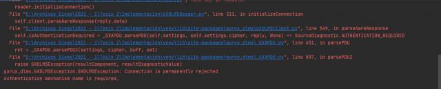

Hi everyone. I am trying to use python libraries to communicate with an Elster A1800 meter. I manage to apply the "readDLMSpacket" method and get the UA response. However, after applying the "parseAareResponse" method I get the "Authentication mecanism is requiered" error even though it indicates a low authentication level when starting the code with its respective password. What can this error be due to? and how can I solve it? Thank you.
I attach the photos of the errors.
Please, don't add images. Plain text is easier to read. Try to run application with -t Verbose argument.
and add send and received bytes. Have you changed the client address with -c argument?
Ok, i won't add images. Yes, i changed the client address with -c argument. The client for Low level Authentication is 17 according to the meter documentation. What do you mean with "and add send and received bytes" ? Thanks for your reply.
You can see the mentioned error here:
"D:\Archivos Diego\2021 - 1\Tesis 2\Implementación\venv\Scripts\python.exe" "D:/Archivos Diego/2021 - 1/Tesis 2/Implementación/main.py"
ClientAddress: 0x11
Security: Security.AUTHENTICATION
System title: 41 42 43 44 45 46 47 48
Authentication key: D0 D1 D2 D3 D4 D5 D6 D7 D8 D9 DA DB DC DD DE DF
Block cipher key: 00 01 02 03 04 05 06 07 08 09 0A 0B 0C 0D 0E 0F
File "D:/Archivos Diego/2021 - 1/Tesis 2/Implementación/main.py", line 28, in <module>
reader.initializeConnection()
File "D:\Archivos Diego\2021 - 1\Tesis 2\Implementación\GXDLMSReader.py", line 311, in initializeConnection
self.client.parseAareResponse(reply.data)
File "D:\Archivos Diego\2021 - 1\Tesis 2\Implementación\venv\lib\site-packages\gurux_dlms\GXDLMSClient.py", line 549, in parseAareResponse
self.isAuthenticationRequired = _GXAPDU.parsePDU(self.settings, self.settings.cipher, reply, None) == SourceDiagnostic.AUTHENTICATION_REQUIRED
File "D:\Archivos Diego\2021 - 1\Tesis 2\Implementación\venv\lib\site-packages\gurux_dlms\_GXAPDU.py", line 651, in parsePDU
ret = _GXAPDU.parsePDU2(settings, cipher, buff, xml)
File "D:\Archivos Diego\2021 - 1\Tesis 2\Implementación\venv\lib\site-packages\gurux_dlms\_GXAPDU.py", line 837, in parsePDU2
raise GXDLMSException(resultComponent, resultDiagnosticValue)
gurux_dlms.GXDLMSException.GXDLMSException: Connection is permanently rejected
Authentication mechanism name is required.
I don't do anything with the python trace. I need the bytes that the client app has sent to the meter.
Run application with -t Verbose argument and you can see the trace from the sent and received bytes.
I believe that your password or client address is wrong.
Connect with GXDLMSDirector and you can see correct command line parameters when you select the meter. Try with this:
