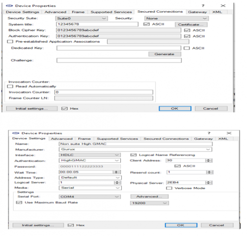

I have implemented the GMAC but not getting info how to set GuruxDirector setting for HLS with GMAC.

Your block cipher key and authentication key must be the same as the meter. If they are, the meter doesn't reply.
The reason why High authentication is used is that your meter returns that High authentication is used and not HighGMAC. The client starts to use it automatically.
https://www.gurux.fi/GuruxDLMSTranslator?translate=7EA05B0002BA696110C9…

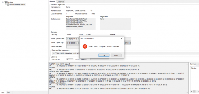

I corrected the mistack in AARE but now when getting response from meter gurux shows error "Access error:Long set Or write aborted"
following is the log:
15:04:54 Send SNRM request.
TX: 7E A0 23 00 02 BA 69 61 93 FA DD 81 80 14 05 02 02 4D 06 02 02 4A 07 04 00 00 00 01 08 04 00 00 00 01 C3 59 7E
15:04:54
RX: 7E A0 23 61 00 02 BA 69 73 09 85 81 80 14 05 02 01 FC 06 02 01 FC 07 04 00 00 00 01 08 04 00 00 00 01 DD A1 7E
15:04:54 Send AARQ request.
TX: 7E A0 5B 00 02 BA 69 61 10 C9 A4 E6 E6 00 60 4A A1 09 06 07 60 85 74 05 08 01 01 A6 0A 04 08 31 32 33 34 35 36 37 38 8A 02 07 80 8B 07 60 85 74 05 08 02 05 AC 12 80 10 70 69 48 41 26 57 16 26 1E 5D 67 45 31 5A 62 00 BE 10 04 0E 01 00 00 00 06 5F 1F 04 00 00 1E 5D FF FF 90 83 7E
15:04:54
RX: 7E A0 67 61 00 02 BA 69 30 E6 5D E6 E7 00 61 4A A1 09 06 07 60 85 74 05 08 01 01 A2 03 02 01 00 A3 05 A1 03 02 01 0E A4 0A 04 08 33 44 4C 07 02 20 00 59 88 02 07 80 89 07 60 85 74 05 08 02 05 AA 12 80 10 61 62 63 64 65 66 67 68 69 6A 6B 6C 00 00 18 4F BE 10 04 0E 08 00 06 5F 1F 04 00 00 10 1D 02 00 00 07 AF 94 7E
15:04:54 Authenticating.
TX: 7E A0 2F 00 02 BA 69 61 32 E3 D8 E6 E6 00 C3 01 C1 00 0F 00 00 28 00 00 FF 01 01 09 11 10 00 00 00 00 99 F2 68 BC 19 78 4C FD 17 79 5B D8 29 2D 7E
15:04:55
RX: 7E A0 27 61 00 02 BA 69 52 F4 DA E6 E7 00 C7 01 C1 00 01 09 11 10 00 00 00 00 D5 62 05 41 EB DB 69 04 D9 61 09 E3 0E BF 7E

aoudumbarpawar
5 years 1 month ago
Hii Mikko,
Hii Mikko,
Thanks!!! Issue is resolved and get authenticated successfully :)
