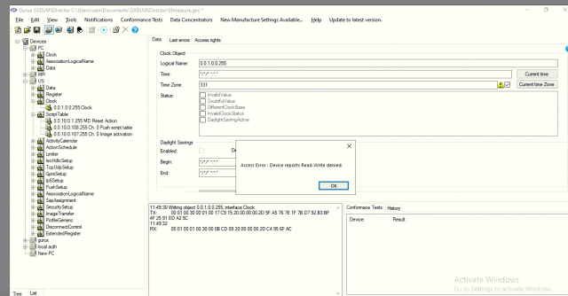

I get the same error when I try to write to the clock object from the GXDirector (attached WriteError1.png).

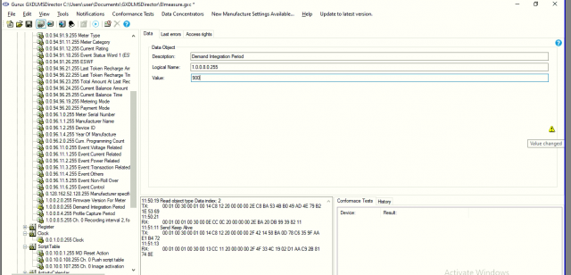

Also, how to confirm write on object 1.0.0.8.0.255 (which the demand integration period), pressing enter brings a yellow warning value changed icon, but write is not sent in the Tx/Rx window (attached WriteError2.png). How to confirm write to object. (1.0.0.8.0.255 has read/write access)?

You can verify the access right if you press "Refresh" from "File" menu. It will read association view and updates access rights. Your timezone value 331 is wrong. Correct that first.
I believe that your meter is using Indian standards.
If you want to write the time, you need to check "Use UTC time zone, not standard" from the meter settings. Without that the time is not correct.

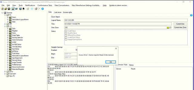

I did not confirm the timezone as 331, but clicked current timezone and selected okay when the dialog box opened for "Are you sure you want to set time zone of the PC to the meter?", that's when the error happened. The 331 was an experiment I was trying to see if I can write, but could not figure out how to confirm the write so left it at 331 itself.
I clicked current time zone button now without changing to 331, it is now 330, but still the same error persists (attached WriteError3.png).

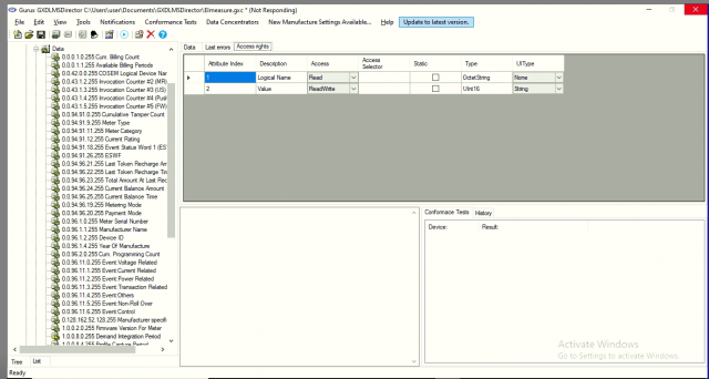

The access rights for object 1.0.0.8.0.255 (which the demand integration period) is Read/Write for the value attribute (attached WriteError4.png).

What is the value if you read the time zone from the meter? Have you checked "Use UTC time zone, not standard"? If I can see the bytes correctly, you haven't check it.

Ther's a checkbox that if I deselect, the "Current time zone" button disables and if I select the button reenables.
After deselection I get the "value changed" icon beside the checkbox, but I don't know how to confirm/ok the write. Pressing enter is not working.

Have you pressed the write button after you did change the value? It's on the right side of the Read button.
Mithun Tiruvedula
5 years 1 month ago
That worked on GXDirector!! Thank you!
