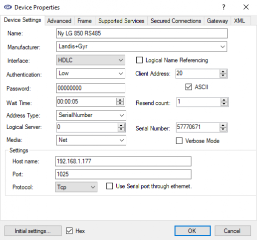

Hope it's ok that I am using this thread, as I think my problem could be the same as Marc's.
We have an LG E850 meter on RS485, and today I updated the DLMS Director, and can no longer contact it. I still have an older version of DLMS Director, and with that version, I can still contact the meter.
I have saved all my meter connections to the file "Meters.gxc", and is using "Meters.gxc" in both versions of DLMS Director.
I am attaching a picture of my connection parameters to this meter. This works in my old Director, but not in the new. Any Idea what I need to do?
5 years 1 month ago
Hi Karl,
Hi Karl,
Please, create a new topic the next time. It's easier to answer the right question.
Try to change the Logical server from zero to 1.
Karl
5 years 1 month ago
Thanks Mikko!
Thanks Mikko!
That was the solution. I will create a new topic the next time. Just thought it was the same problem, so thought it was better to use the same topic, than create a new one :)
