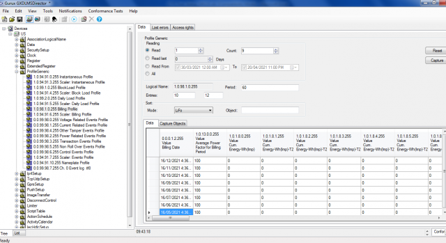

I having a problem while reading billing data through Gurux client.

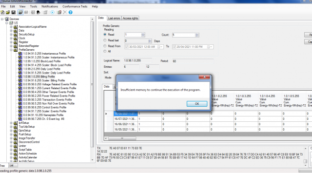

I have 10 months records. when i am trying to read 1-5 ,1-9 count based read it it showing (1-5):=4 records instead of 5, (1-9):=8 records instead of 9 and throwing error insufficient memory.

It's hard to say, but this feels like the problem with the meter manufacturer. They were started index from zero when DLMS standard defines that it should start from 1. You should verify this.

Thanks for reply,
In flash I am writing from index 1(Not zero). then also it is showing the same problem.
