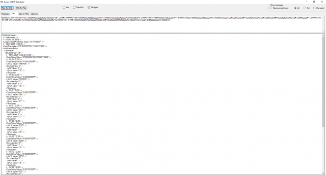

I got the data decrypted so far. I just need to translate them with which function do I do this? I checked the data with the translator in the GXDLMSDirector on Windows.
I just need the function from PDU to XML
I'm programming in Python.
BR, Michael

I have tested this function so far and am almost satisfied with the result. Unfortunately, it doesn't give the same result as when I use the online translator.
Decrypted data:
0f800330070c07e502040409122d00ffc4020223090c07e502040409122d00ffc40209060100010800ff060001832302020f00161e09060100020800ff060000011802020f00161e09060100010700ff060000004c02020f00161b09060100020700ff060000000002020f00161b09060100200700ff1208f402020fff162309060100340700ff1208f302020fff162309060100480700ff12091a02020fff1623090601001f0700ff12003102020ffe162109060100330700ff12001302020ffe162109060100470700ff12000102020ffe1621090601000d0700ff1001df02020ffd16ff090c3137383217434aef736eaaa1781d8fc5bbdbfc68ffa0f4
Online Translater:
