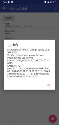

I've my android phone to Secure Energy Meter sprint 350 using FTDIBUS Vendor Id :1027 and Product Id : 24597 (Modified isUsing function in GXFtdi.java to accept the same in gurux.serial.android)
Meter is not responding back after snrm request is sent.
Chipset : FTDI
FTDI device (Device Info) : FTDIBUS\VID_0403+PID_6015+5&310c8a00&0&7\0000
Snrm request : 7E A0 07 03 41 93 5A 64 7E

Request Screenshot
Request Screenshot
