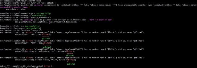

What compiler do you use for ARM and what operating system?
When compiling it gives me the error that appears in the image.
Thank you.

after doing it, now it gives me this error.

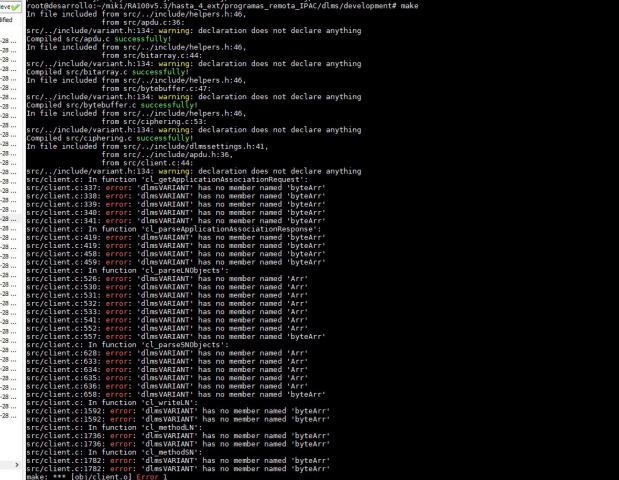

in another compiler it gives me this error.
Thank you.

We have tested on a debian 10: with the following compiler arm-linux-gnueabi-gcc:
COLLECT_GCC=arm-linux-gnueabi-gcc
COLLECT_LTO_WRAPPER=/usr/lib/gcc-cross/arm-linux-gnueabi/8/lto-wrapper
Target: arm-linux-gnueabi
Configured with: ../src/configure -v --with-pkgversion='Debian 8.3.0-2' --with-bugurl=file:///usr/share/doc/gcc-8/README.Bugs --enable-languages=c,ada,c++,go,d,fortran,objc,obj-c++ --prefix=/usr --with-gcc-major-version-only --program-suffix=-8 --enable-shared --enable-linker-build-id --libexecdir=/usr/lib --without-included-gettext --enable-threads=posix --libdir=/usr/lib --enable-nls --with-sysroot=/ --enable-clocale=gnu --enable-libstdcxx-debug --enable-libstdcxx-time=yes --with-default-libstdcxx-abi=new --enable-gnu-unique-object --disable-libitm --disable-libquadmath --disable-libquadmath-support --enable-plugin --enable-default-pie --with-system-zlib --with-target-system-zlib --enable-multiarch --disable-sjlj-exceptions --with-arch=armv5te --with-float=soft --disable-werror --enable-checking=release --build=x86_64-linux-gnu --host=x86_64-linux-gnu --target=arm-linux-gnueabi --program-prefix=arm-linux-gnueabi- --includedir=/usr/arm-linux-gnueabi/include
Thread model: posix
gcc version 8.3.0 (Debian 8.3.0-2)
AND IT GIVES US THE FOLLOWING ERROR:
/gxvalueeventargs.c: In function ‘vec_attach’:
src/gxvalueeventargs.c:64:15: warning: assignment to ‘gxValueEventArg **’ {aka ‘struct <anonymous> **’} from incompatible pointer type ‘gxValueEventArg *’ {aka ‘struct <anonymous> *’} [-Wincompatible-pointer-types]
arr->data = value;
Compiled src/gxvalueeventargs.c successfully!
Compiled src/dlmsSettings.c successfully!
src/notify.c: In function ‘notify_parsePush’:
src/notify.c:278:43: warning: cast to pointer from integer of different size [-Wint-to-pointer-cast]
arr_push(items, key_init(obj, (void*)(uint64_t)index));
Compiled src/notify.c successfully!
Compiled src/message.c successfully!
src/variant.c: In function ‘convert’:
src/variant.c:1612:37: error: ‘dlmsVARIANT’ {aka ‘struct tagdlmsVARIANT’} has no member named ‘fltVal’; did you mean ‘pfltVal’?
sprintf(buff, "%f", tmp.fltVal);
pfltVal
src/variant.c:1628:38: error: ‘dlmsVARIANT’ {aka ‘struct tagdlmsVARIANT’} has no member named ‘dblVal’; did you mean ‘pdblVal’?
sprintf(buff, "%lf", tmp.dblVal);
pdblVal
src/variant.c:1763:58: error: ‘dlmsVARIANT’ {aka ‘struct tagdlmsVARIANT’} has no member named ‘fltVal’; did you mean ‘pfltVal’?
sscanf((char*)tmp.strVal->data, "%f", &item->fltVal);
pfltVal
src/variant.c:1774:59: error: ‘dlmsVARIANT’ {aka ‘struct tagdlmsVARIANT’} has no member named ‘dblVal’; did you mean ‘pdblVal’?
sscanf((char*)tmp.strVal->data, "%lf", &item->dblVal);
pdblVal
make: *** [makefile:33: obj/variant.o] Error 1
WE HAVE ALSO TESTED ON AN UBUNTU 10.04 WITH THE ARM-LINUX-GCC COMPILER:
arm-linux-gcc (GCC) 3.3.2
Copyright (C) 2003 Free Software Foundation, Inc.
This is free software; see the source for copying conditions. There is NO
warranty; not even for MERCHANTABILITY or FITNESS FOR A PARTICULAR PURPOSE
GETTING THE FOLLOWING ERRORS
In file included from src/../include/helpers.h:46,
from src/apdu.c:36:
src/../include/variant.h:134: warning: declaration does not declare anything
Compiled src/apdu.c successfully!
from src/bitarray.c:44:
Compiled src/bitarray.c successfully!
from src/bytebuffer.c:47:
Compiled src/bytebuffer.c successfully!
from src/ciphering.c:53:
Compiled src/ciphering.c successfully!
In file included from src/../include/dlmssettings.h:41,
from src/../include/apdu.h:36,
from src/client.c:44:
src/client.c: In function 'cl_getApplicationAssociationRequest':
src/client.c:337: error: 'dlmsVARIANT' has no member named 'byteArr'
src/client.c:338: error: 'dlmsVARIANT' has no member named 'byteArr'
src/client.c:339: error: 'dlmsVARIANT' has no member named 'byteArr'
src/client.c:340: error: 'dlmsVARIANT' has no member named 'byteArr'
src/client.c:341: error: 'dlmsVARIANT' has no member named 'byteArr'
src/client.c: In function 'cl_parseApplicationAssociationResponse':
src/client.c:419: error: 'dlmsVARIANT' has no member named 'byteArr'
src/client.c:458: error: 'dlmsVARIANT' has no member named 'byteArr'
src/client.c:459: error: 'dlmsVARIANT' has no member named 'byteArr'
src/client.c: In function 'cl_parseLNObjects':
src/client.c:526: error: 'dlmsVARIANT' has no member named 'Arr'
src/client.c:530: error: 'dlmsVARIANT' has no member named 'Arr'
src/client.c:531: error: 'dlmsVARIANT' has no member named 'Arr'
src/client.c:532: error: 'dlmsVARIANT' has no member named 'Arr'
src/client.c:533: error: 'dlmsVARIANT' has no member named 'Arr'
src/client.c:541: error: 'dlmsVARIANT' has no member named 'Arr'
src/client.c:552: error: 'dlmsVARIANT' has no member named 'Arr'
src/client.c:557: error: 'dlmsVARIANT' has no member named 'byteArr'
src/client.c: In function 'cl_parseSNObjects':
src/client.c:628: error: 'dlmsVARIANT' has no member named 'Arr'
src/client.c:633: error: 'dlmsVARIANT' has no member named 'Arr'
src/client.c:634: error: 'dlmsVARIANT' has no member named 'Arr'
src/client.c:635: error: 'dlmsVARIANT' has no member named 'Arr'
src/client.c:636: error: 'dlmsVARIANT' has no member named 'Arr'
src/client.c:658: error: 'dlmsVARIANT' has no member named 'byteArr'
src/client.c: In function 'cl_writeLN':
src/client.c:1592: error: 'dlmsVARIANT' has no member named 'byteArr'
src/client.c: In function 'cl_methodLN':
src/client.c:1736: error: 'dlmsVARIANT' has no member named 'byteArr'
src/client.c: In function 'cl_methodSN':
src/client.c:1782: error: 'dlmsVARIANT' has no member named 'byteArr'
make: *** [obj/client.o] Error 1
