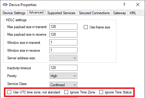

Some meters are accurate from the date time structure. Try to start by setting time settings from the advanced tab in GXDLMSDirector (see pic.). Try to find right combination.

However, we are not possible to read data by range and entry also. Can read data for all only.
Applied all six possible combinations.
