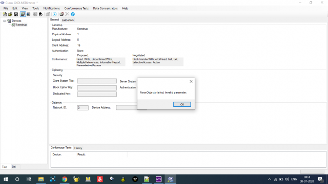

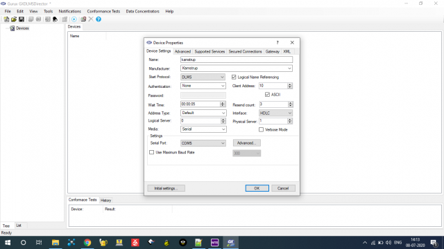

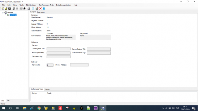

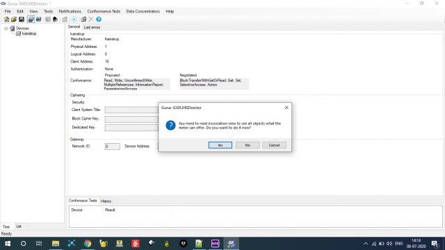

I have already tried those settings using the DLMS director. Still, I tried once again and still I am not able to read the meter via RS485 port.PFA
ayush
6 years ago
Attachment -2

Those pictures don't give me any information. Have you change Max payload to 1010?

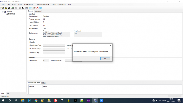

But when trying to read with authentication LOW, I am getting an error. I have given the addresses as per the doc.PFA

Please, don't add pics. They don't give me any info.
Try to change the client address. If you are using optical head it's 0x13. I can't remember what value you should use with RS-485 right now. They are described on the meter documentation. If you don't have that you can try with different values.
