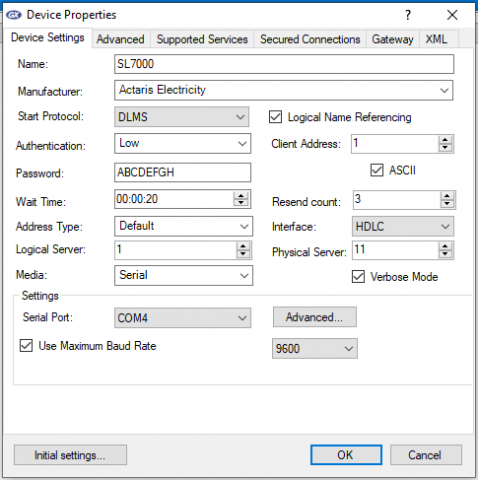

Thanks for your attention, We connect SL761X071 Meter through Serial port RS232, configured 9600 8N1None, with Initial Settings like File, please may you tell us how to access with write privilege?

What do you want to write? You can't write all the objects and some are requiring special client address.
There are two logical devices.
- Electricity 1
- Management 2
There are four client modes.
- Laboratory 1
- Field 2
- Reader 3
- End customer 7
